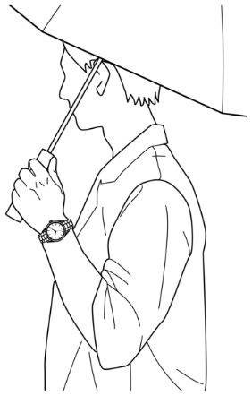

Even when you are wearing the watch, the mainspring may not be wound well in situations where your arm movements are limited, as illustrated below.
Desk work
Desk work
Holding an umbrella
